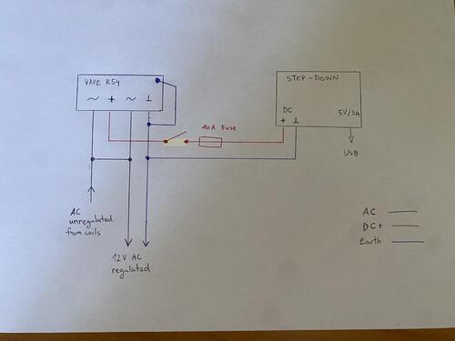

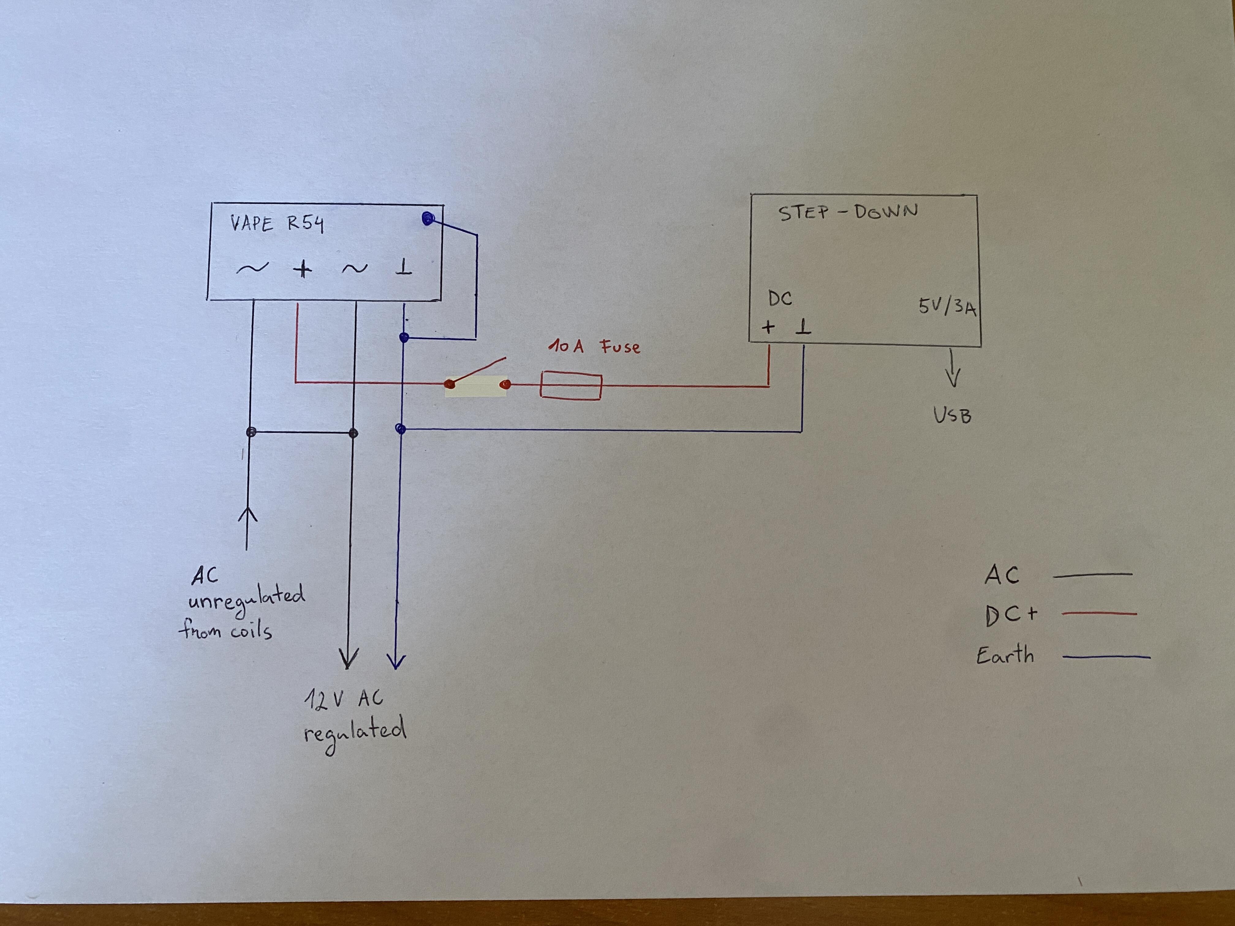

Maybe someone thought about it and i missed it. If yes, then I am sorry and please direct me to the correct thema.
But a quick question... Can this work? Or how would you modify it? Thanks.
I think this dosn't work, becous of the original "Rectifier". To open the B+ connector it will have an 12V Signal on Sense "C". So the USB Converter dont get 12V and can not give 12V to Recetifier.
A sort of this 4 Pole Rectifier should work.
But i dont how the behavor of this USB Defice is with an unstable Voltage on lower RPM. Maybe it crash over time.:???:

Ah, OK. So to open Sense I need regulated 12V DC? So if it was a battery it would be ok? Or could I use the 12V AC blue wire? I wanted to try this original rectifier because I already have it. But if it can't work, I'll use the BGM one.
AC dont work or not long or not in the right order and kill some things on the pcb.
there are some topics in the GSF /about to replace a batterie with a LiPo (or Otter typs) Batterie or with an capasitor (GSF Wiki). Im on on the run and cant search the links for you in time. maybe in monday.
..but this are other things in "solution in search of a problem"
Bearbeitet von hiro LRSC
schematic, yes.
but :satisfied: i found this topic about the vape r54. The DC output at R54 is unstable. It's probably necessary to connect a capacitor in parallel.
The step-down has got a tolerance from 7 - 22 V, so I think that this unstability should be ok for only charging a phone. I will test it and see. Might add the capacitor. Thank you for your help! :laugh:
