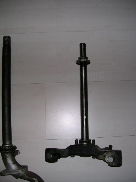

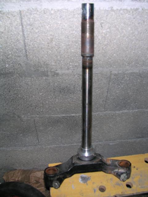

So, to answer the questions:
* It's a MBK booster fork, some picture here and there: http://ktylife.free.fr/vespa/KTy133/FourcheBooster.JPG and http://ktylife.free.fr/vespa/KTy133/FourcheBoosterVespa.jpg
* They were much more work on the *cases* to match the transfers of the cylinder. It's probably not perfect, I tried to do what I had understand from px200hh's topic :) Please, feel free to explain to me what you think I should have done... ;)
Anyway, the scooter is a blast, even if I had to put a 2.34 primary because the 2.54 GSF prepared couldn't fit my cases :uargh:
