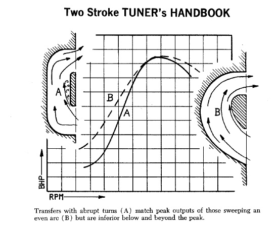

@audiard2: What you call an obstructing bump might be a resonable port design (B):
@Marian: Ja. Ich würde auch diese "Wand" entfernen. Mit CVF wie im Topictitel hat das aber nix zu tun.
Yes Brosi, you're right: it's part of the transfert design but however it reduces drasticly (accelerate probably too) the gaz flow. Usefull for a torkey tourer but maybe a brake for higher rev and power. If you give a look at the original cylinder the design inside the transfert is less brutal, more natural as on Pinasco's and polini's...
