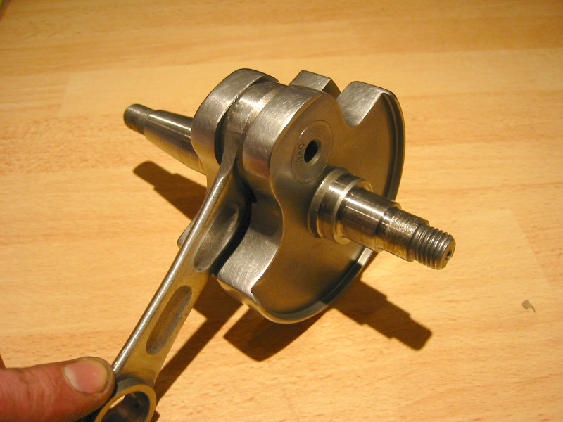

And in terms of balancing: The full circle Mazzuchelli is the worst possible in terms of balancing! It has absolutely no counterweight to the rod and piston, the rotating masses are even adding with the translational ones, not equalizing each other!
I also ride it, but I cutted it to a balancing ratio of 50% with the GS Piston.
With the original full circle it was hardly possible to let the scooter run on the sidestand, now it is almost vibrationless.
Greetings, jan
Bearbeitet von jannek

@Gerhard: Your ETS crank is an original one ? Recut ? Picture :-D ? No problem to put it on primavera (VMA2T) cases ?
Does anyone want to comment on Jannek's crank ? Could this be the best option for huge case induction ? Having a look at engine like NSR 125 and TZR 125, the crank is full-circle (with counterweight) not really "flow favorable", maybe the cheeks are quite thin...
So is it really worthless to do like Jannek ?

tzr and the like have a completely different valve angle, in their case the inlet port points upwads toward the cylinder, and the conrod is much longer. in your case it points towards the center of the crankcase, so flowing the crank is much more important simply because it actually is in the way of the gas.
