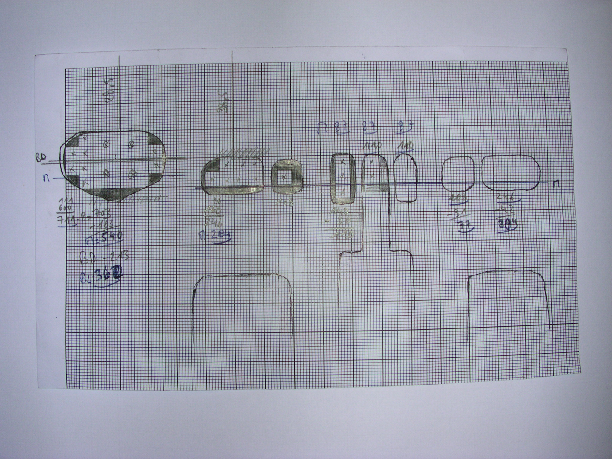

I'm back again on my Polini 133 project :-D , well it's more a KTy 134 now... ;-)
I have a 58mm GS piston and I'm doing a port map of my actual cylinder (already modified)...
I didn't work too much on my exhaust port width, and now what I measure is odd too me.
On *the paper* of my port map, I measured a maximum exhaust port width of 37mm. So, the actual width of the port is: 58*sinus(37/58) = 34.5mm , that is 59.5% of the diameter of the piston. Could this be correct ?
I'm planning on increasing the exhaust port to 69-70%, that would be a 40.5mm port width (44.9mm width on the plannar port map), 6mm more compare to my existing port ! :plemplem:
So if I haven't made any calculation mistakes, here goes my question: On a Polini 133, can you enlarge that much the exhaust port without making a "hole" in the exhaust transfer ? :-D
I don't want to see the studs through my exhaust port !! :plemplem:
Thanks for your help ;)

there is enough flesh around the exhaust Port all the way out, but you have to be very careful.
another thing to concern is the amount of sealing surface for the header.
this is why I suggest to put a 1 cm piece of iron between the Cylinder and the header flange.
you than got a longer exhaust port to smooth the flow between a rather "squared" exhaust window and the round header pipe.
the polini exhaust port is too short anyway and by this method you can achieve a round outlet of the desired diameter without any sealing problems.
regards :-D
I measured 36mm sehnenmaß (can´t find the english word, but what you called "actual width of the port"). But the port might have been enlarged already, as it´s second-hand :-D . I enlarged it to 40mm radian measure (on port map) wich is 70 % of the cylinder diameter. I also widened the exhaust side of the port to 32 mm diameter and had no such problems as "holes"...
Yes.
This correct.
You have to be careful, when you continue with the exhaust diameter to the flange and raise the diameter to 1,1 x 40,5 mm. The wall is very thin and my polini has two holes where the studs end.
my guess is, that many people raise the exhaust port to 70% and adjust the flange diameter accordingly. but the projected path of the exhaust gases is not considered enough (or more posts would have come up here).

Any advices and experiences on different shapes for the exhaust port ?
I read that a rectangular port is more noisy but delivery very sharp wave pulse that could make the exhaust works better. Oval shape is common, but could reduces exhaust efficiency. Finally, V shape or trapezoid is often found on modern cylinder...
I was thinking that because I have to enlarge of 6mm (!!) the width, I could enlarge the exhaust port width to 70% just for the blowdown area... Just an idea.... :wasntme:

First point is, I didn't correct the boost port area ;-). Reading MacDizzy I was planning to do it, then I forget ! But, my understanding of this problem of steep angle is that it shouldn't change the timing nor the heigth of the boost port. A corrected factor should only affect the area, as few mixture can flow through this port... But that's my understanding ! I have also milled a lot this port even though it's still not much...
Have You already any idea which range to take as targets? What about the blowdown area?
That's where I'm stuck right now... I don't really know what to target in term of T.A values and BMEP... And anyway, my timing are already "extreme" (199/133/35), so the only thing I can try to optimize is the transfer width and of course, the exhaust width. As for the Blowdown Area, ... what is the question ? :plemplem: ;-)
In your portmap I found the aux transferport having a bigger value ATDC, maybe You should correct the mean port area line of this port.
Maybe I don't calculate well the mean line :-D . I thought it was only a function of the transfer opening timing... As both primary and secondary transfer have the same height (there is a drawing mistake but I correct it), I thought they would have the same mean line... :wasntme: ?

;-) question ist the same as on the other TA targets, I have definitely no Idea (except of the chart in the escel sheet)
sorry, I didn´t get, that there´s a drawing mistake, then you´re right, it should be the same mean line
