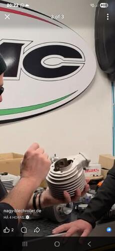

  1. Vmc project for Larchotek. Comparing both cylinder in larchotek photos and vmc office and the same. Dolomiti have some design details caracteristic from vmc

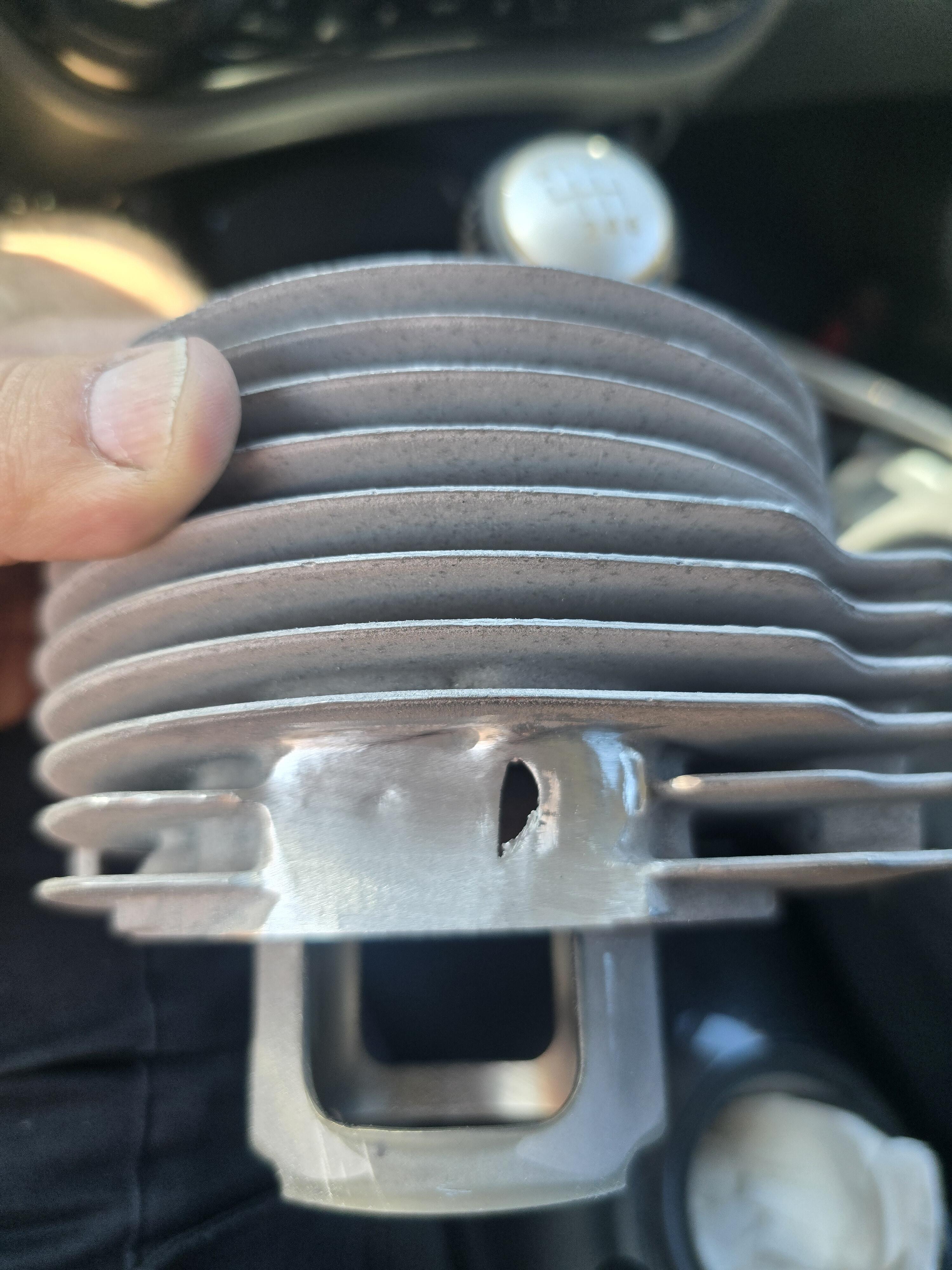

  2. No. Vmc will bring new batch with stelvio 2.0 with changes to go with eletric start. I change one but i need to weld and cut

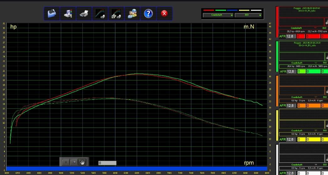

  6. This is with W1R TORQUE. less torque and power. After a put polini and is big diference. More quick in road in all aspects ...top speed and mountains

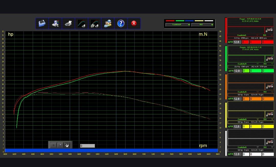

  8. Stelvio 2.0, crank 60, carb pinasco 26/26r, sip vape static, bbt2
  9. VMC explorer # VMC ranger = +-100 euros crank bgm 60/128 # crank bgm 60/110 = +-45 euros carburator (si 26/26r), exhaust (polini box), clutch, ignition is the same in engine 2000-2500 euros, 150 euros diference is small. i think that if explorer bring more 2/3hp and 2/3nm in same setup so the 150 is well spent
