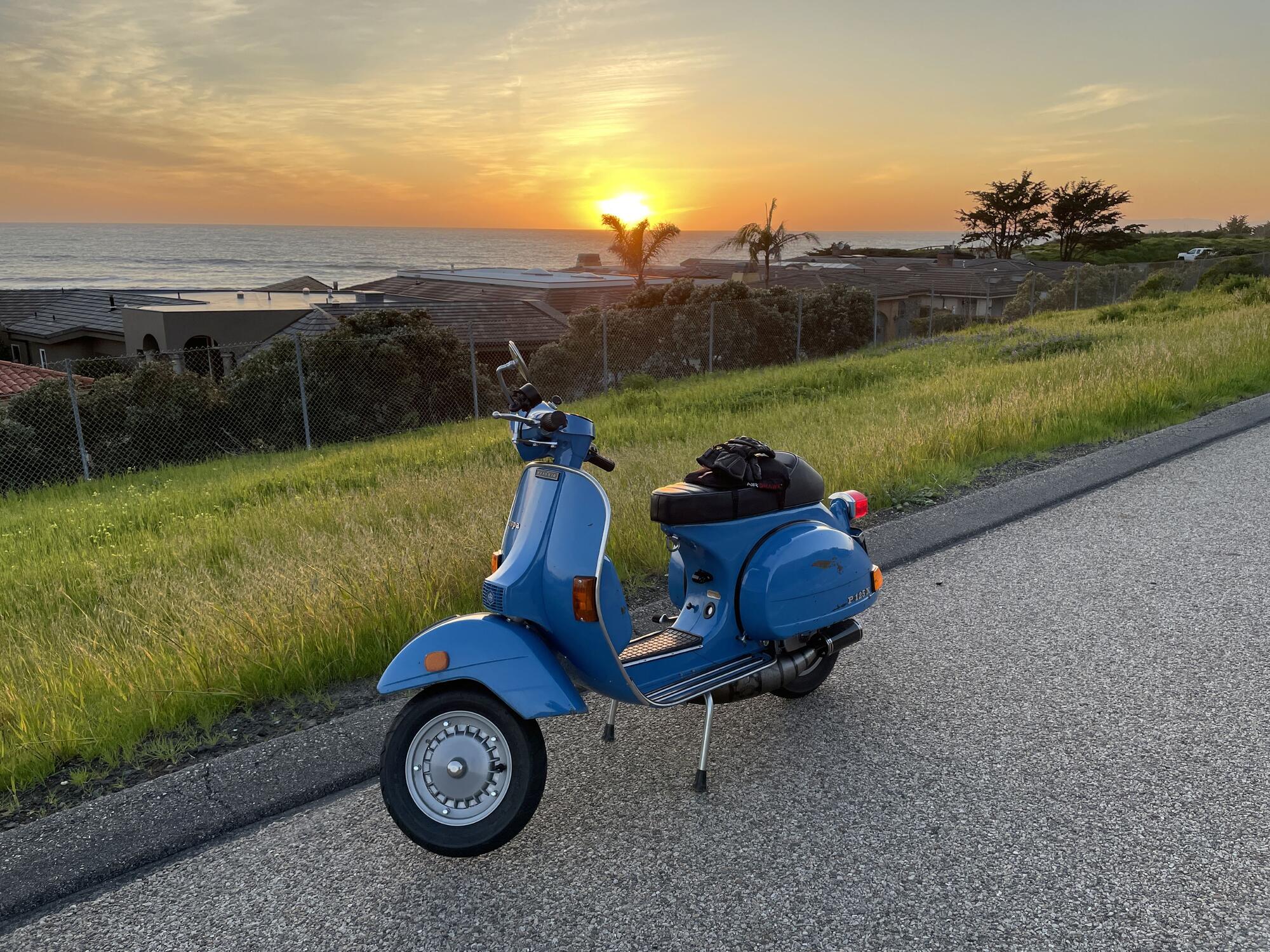

  6. Glücklich mit 23/60 benelli super short 4th. M265 40+ PS Highway ist kein Problem und immer noch eine Menge Spaß auf der Straße. 2. Gang Beschleunigung Wheelie den ganzen Tag.
  7. Both nicely done with a nice photo as well. Is the seat on the green a custom or store bought? Drive the Posch Box under the green PX. Without a silencer it was way too loud for me. Then I had a muffler built and the whole thing became much more pleasant. An internally insulated Racing Resi is currently on its way to me from Jürgen. I'm curious about the volume.
