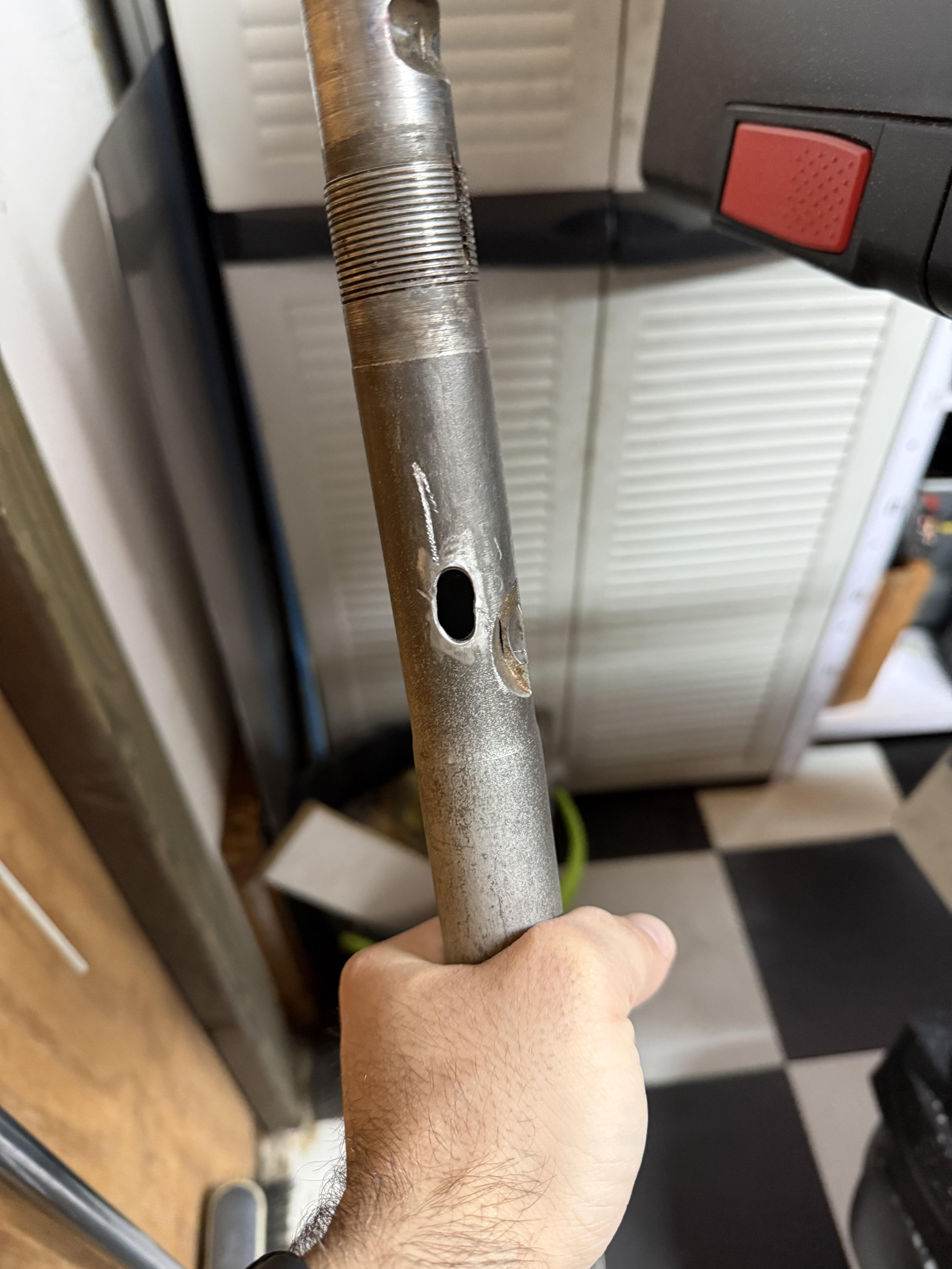

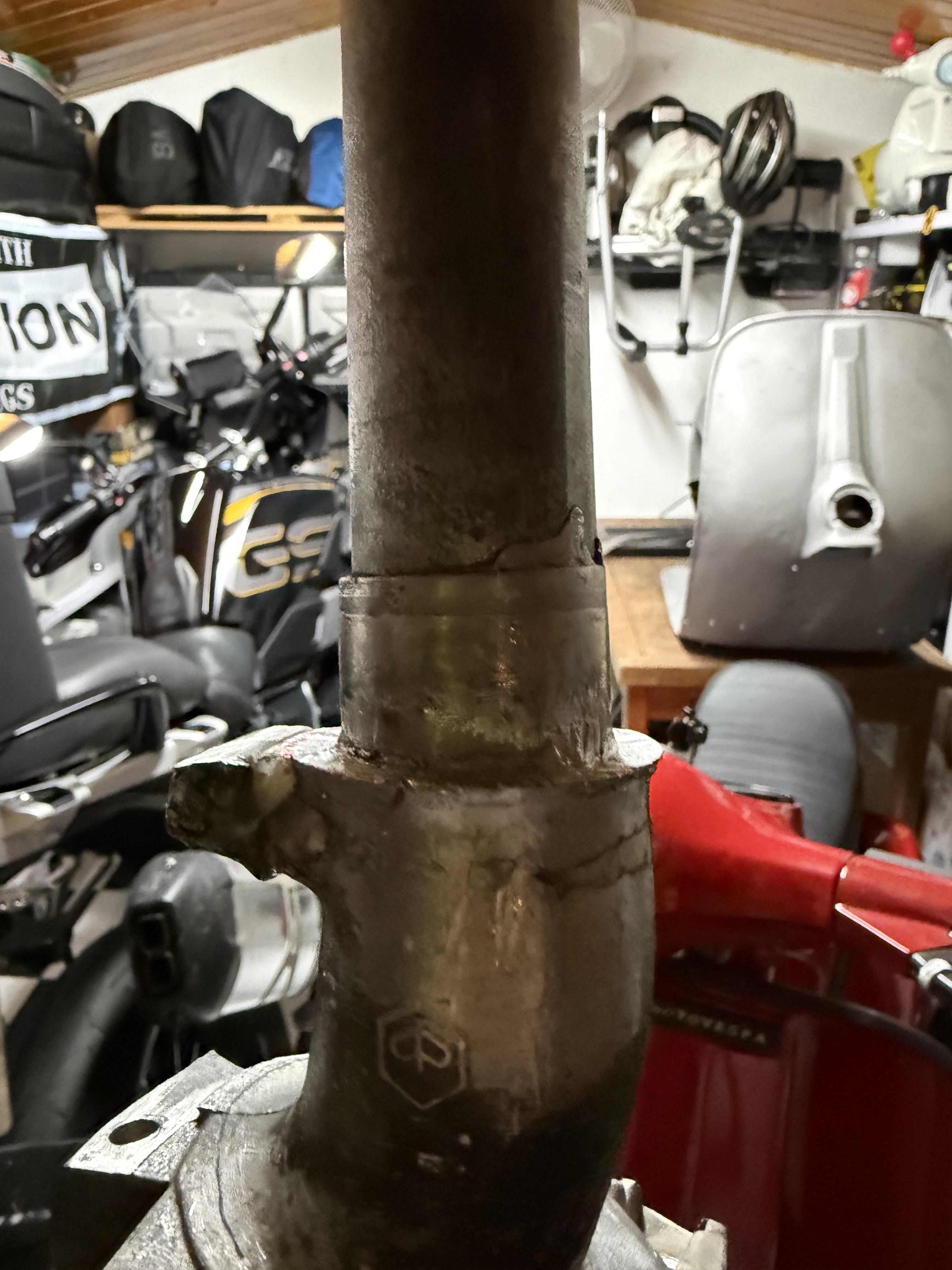

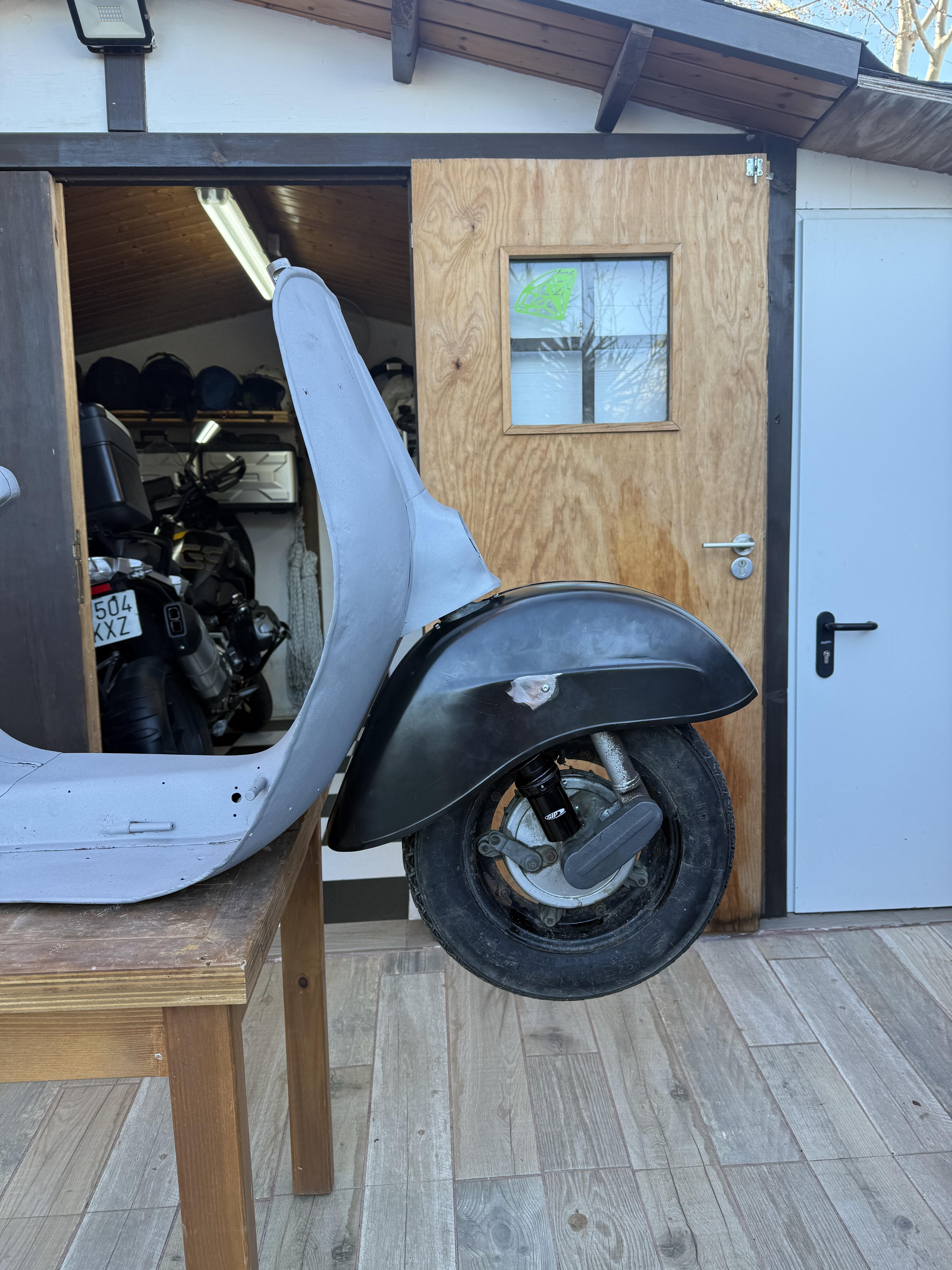

  1. 👌🏼👌🏼nice job 👏🏼 I’m installing pk xl fork in MV 150GS with disc brake and I had to adjust the height by 1.3cm in the central area. I'm now doing the same thing on a 125L 60' and it's definitely more work; that chassis is almost identical to the first series 150S.
  2. PX-Gabel? Wenn du PKS- oder PKXL-Gabeln verwendest, musst du nichts abschneiden.

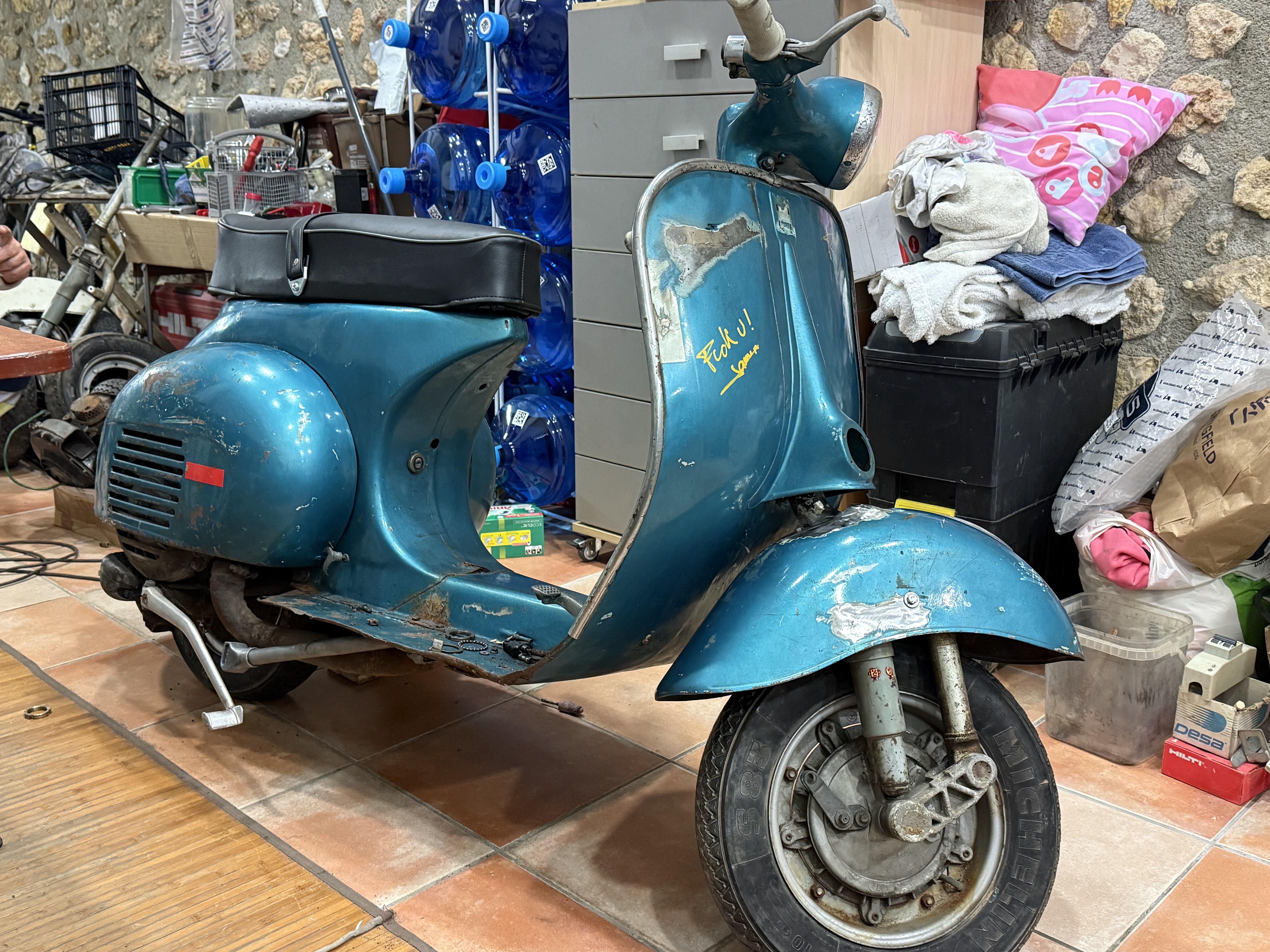

  4. Motovespa 150s segunda serie color Marfil Kenia
