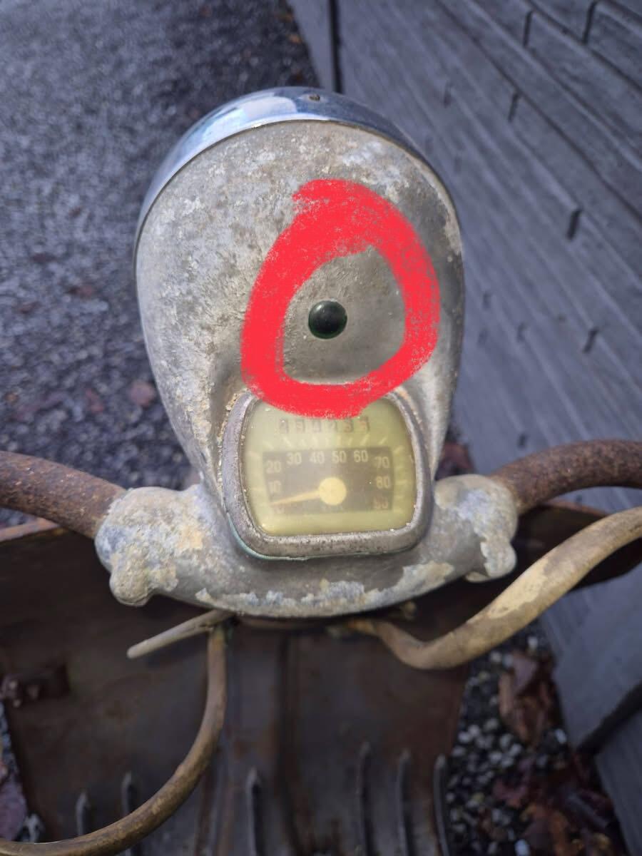

  2. Servus. Do you know what model years this light indicator was in? Cheers!
  3. But here in the pictures you have a switch of the old type - there is a different way of connecting the contacts
