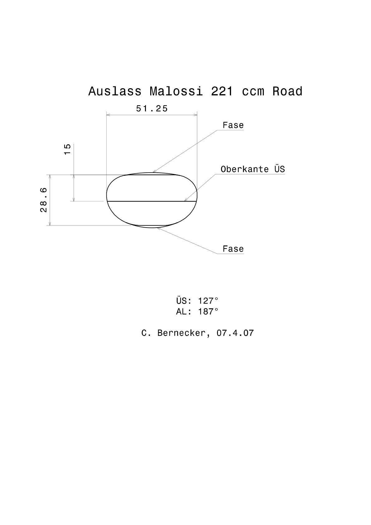

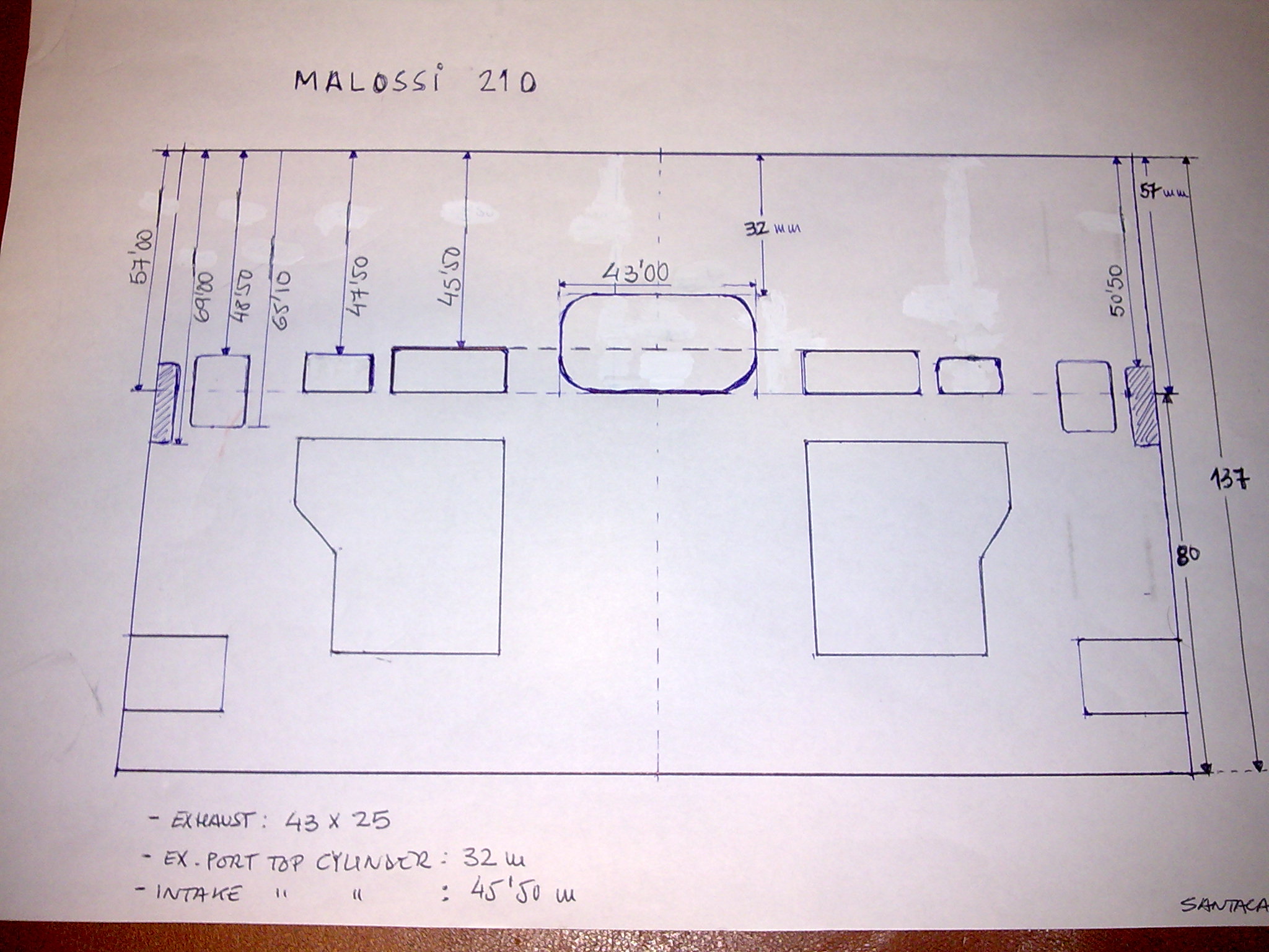

  16. I am building a Malossi 221: Would anyone know the exhaust degrees suitable for a JL Right Hand? Thanks.

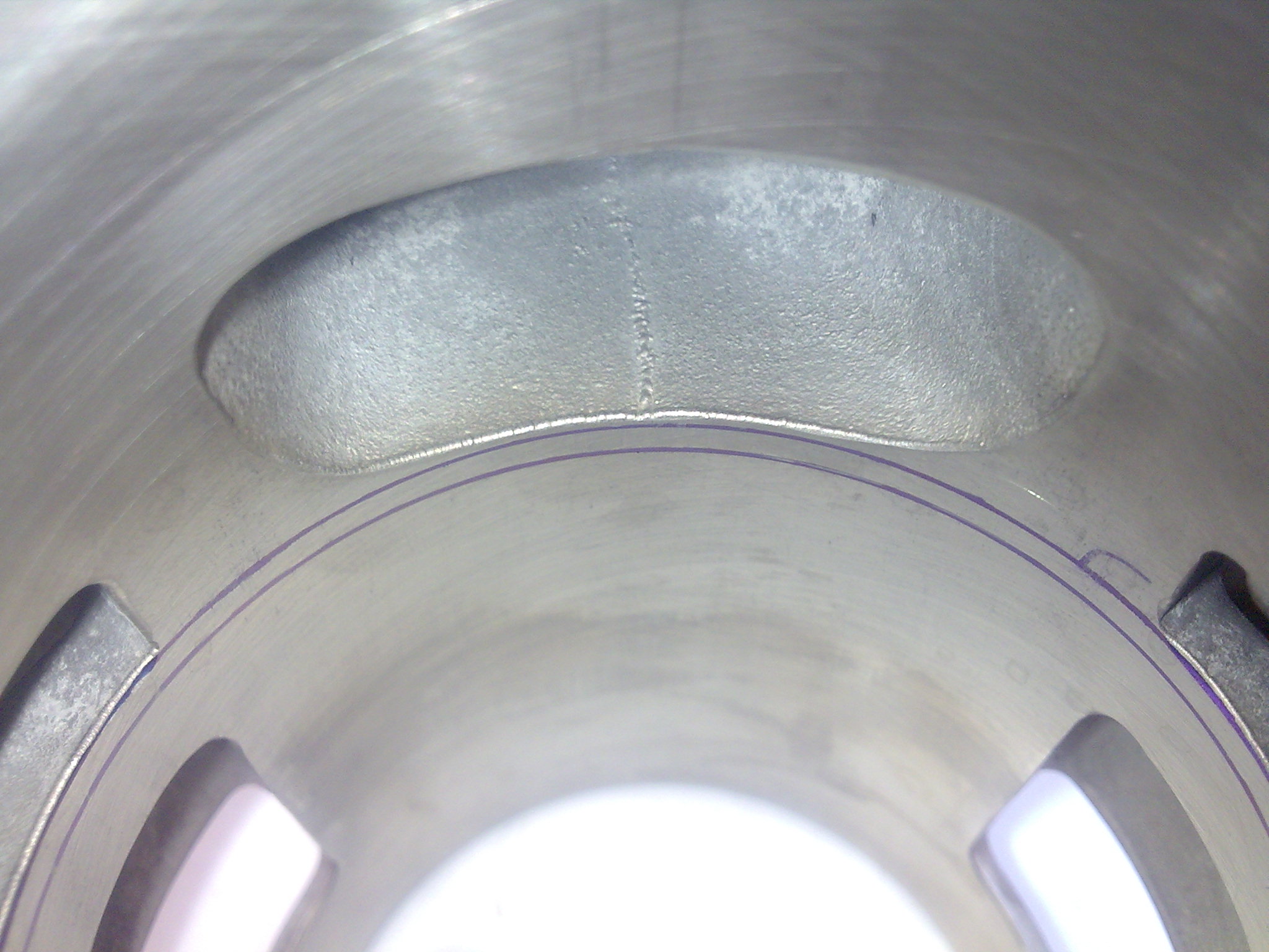

  19. Thanks for the info. Yes I have the right tools and this is not my first trasnformación of a cylinder. The most important thing for me now is knowing what to do with the intake and exhaust ports. The 60 mm crankshaft gets the piston crown 1.5 mm lower than the 57 mm, that joined with the 1.5 mm basegasket, causes the piston crown to be 3 mm below the lower line of the intake and exhaust ports: as you can seen in the previous picture: what do you do with those 3 mm? Ultimately what modifications are needed to do to the intake and exhaust ports? Is the one in de pic OK: Finally, How would the behavior of the engine be with a timing of 190/30? Thanks to all.
