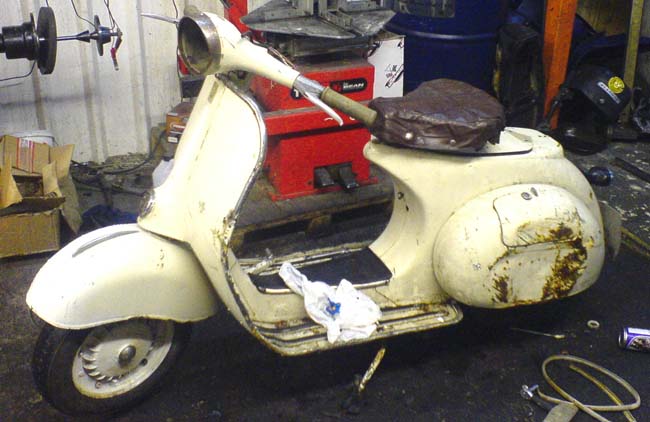

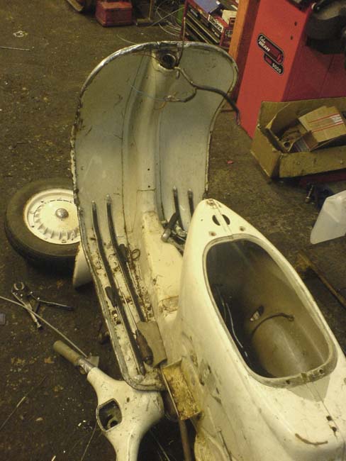

  5. oh.. i come from england, portsmouth!! heres another pic.. may help?
  6. thankyou guys! really helpful of you. ok i think i understand!! ......so what is the Vehicle Identification Number (VIN) on the body chassis for? (VGLA1T032201) It matches a GL VIN number and apparantly (on this site http://www.scooterlounge.com/Vespa/GL/GL.asp - ) they did make GL's like this before 1963 brought in the squarer make??? so does the chassis VIn number mean the chassis was made in Italy and the rest was done in germany? here is a picture before it was restored... its not very clear! the vespa was restored before i got it but i will have a look at the special parts to see. thjnx for you help.. i really appreciate it.
