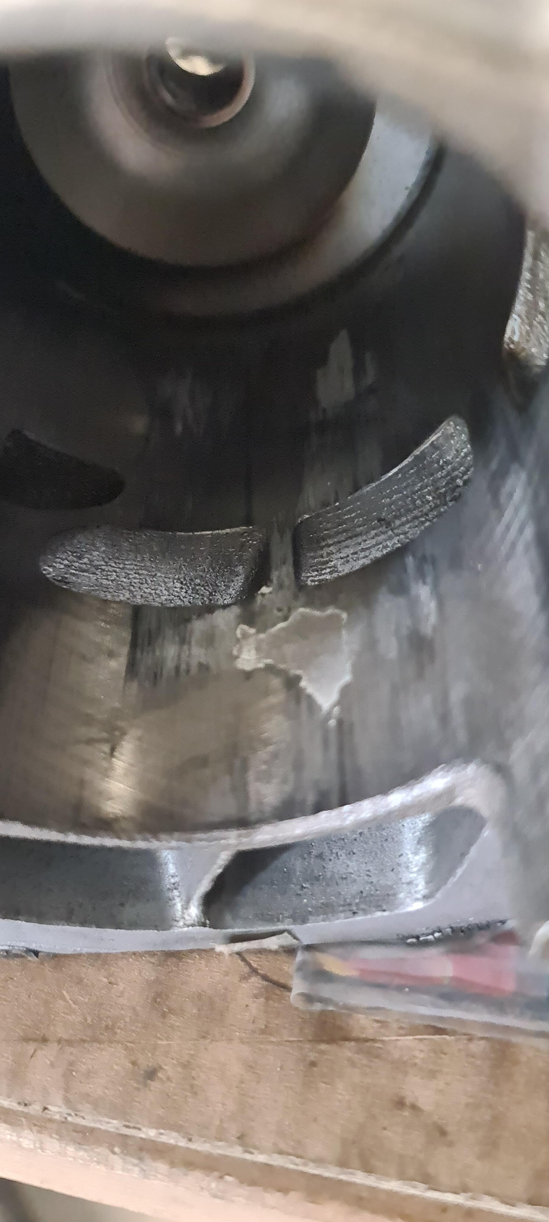

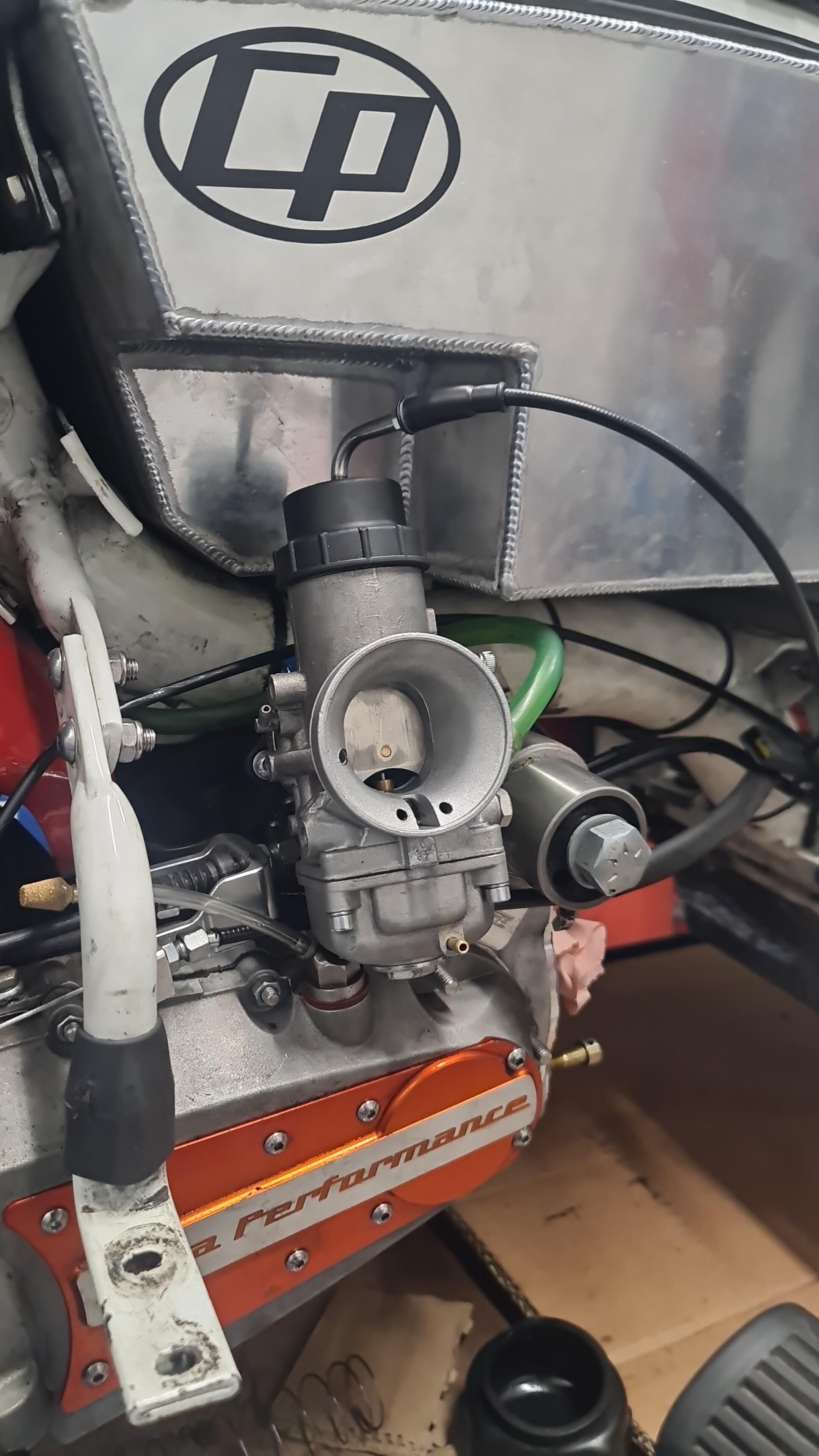

  1. I had the same problem two months ago. We fitted a new KTM EXC380 piston (fits our BFA perfectly) and had the cylinder's Nikasil coating redone at Airsal. Regarding the carburetor, we adapted the manifold to install a VHSB 34. However, carburetor adjustments are complicated with these engine sizes. Since the breakdown, I no longer dare to ride at full throttle. I'm continuing the adjustments, but as you say, it's difficult to adjust the needle and the diffuser.

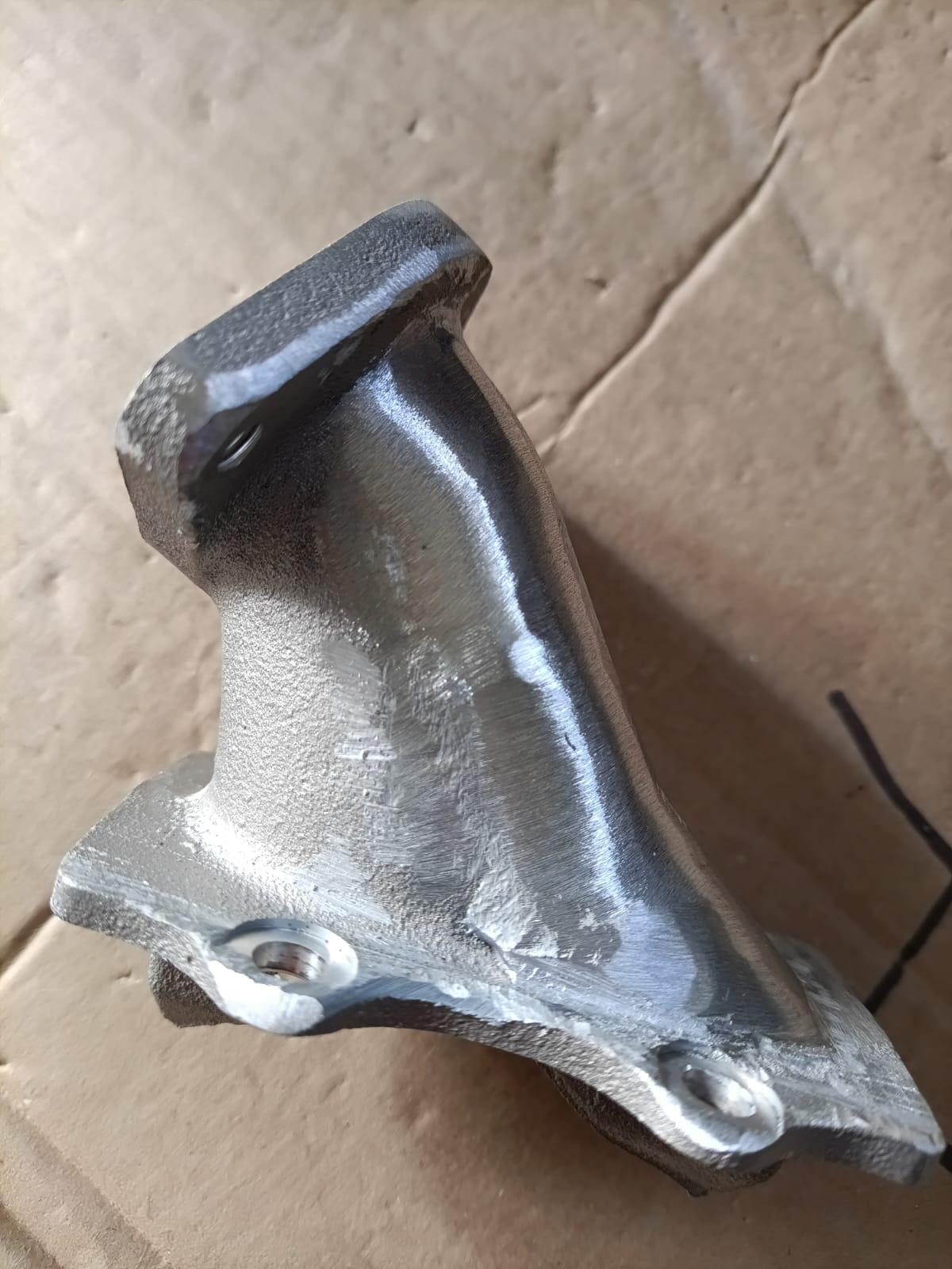

  2. During a ride with my buddy and his SSR265—where we love to push hard on the throttle—we hit a stretch of highway. My BFA seized under full load, trashing the piston and stripping the Nikasil coating right off the cylinder. The Rebuild: We hunted down a replacement piston and went with a KTM 380EXC unit. It’s a perfect match for the BFA but way cheaper at €190 (vs. SIP’s €300). For the cylinder, we did some light porting: raised the exhaust port timing and tweaked the transfers before shipping it to AIRSAL in Spain for a fresh Nikasil coat. While waiting for the cylinder, we fitted a 34mm VHSB carb, reshaped the intake tract, and machined it for better flow. This thing is a monster now. The BFA just rockets forward with every twist of the wrist—torque is through the roof, and acceleration is brutal. Couldn’t be happier with how it turned out!

  4. Solo, no 3M this year, we plan to go to Eurolambretta from western France
