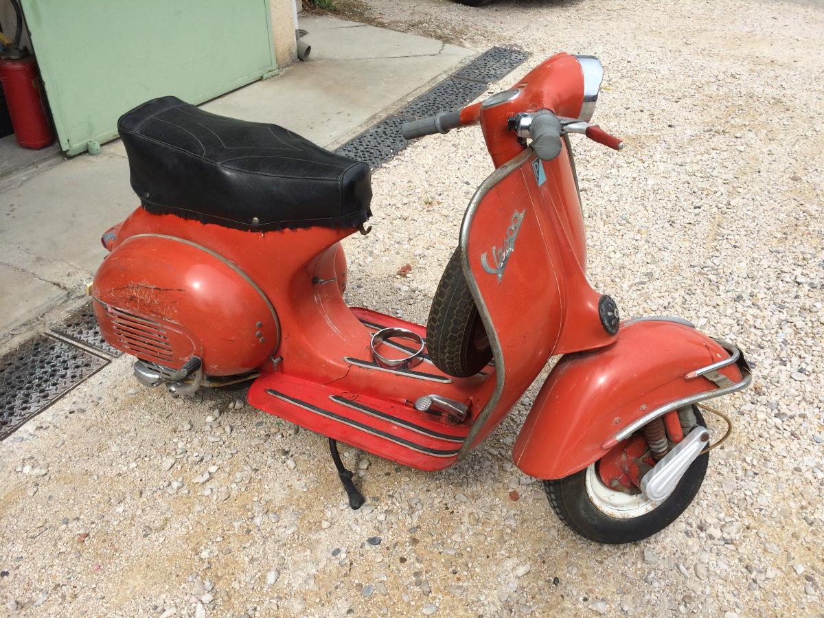

  3. Everyone!, First I deeply apologise for writing in English on a German forum, but I recently moved to Munich and I do not master the German language yet. I am restoring a 1961 ACMA Type N with my cousin, in France, and I would like to import it to Bayern when it is ready, to use it myself (not to sell it). It has all original paperwork from 1961, and it is in good conditions. However I am considering swapping the engine for a PX engine, in order to get a bit more power, and proper 12v lighting. The original engine is in very condition and I will keep it. My question is: Do I need to present it to TUF with the original engine and condition (It has no brake lights, turn signal...) in order to get it registered in Germany? If not, can I get it approved with a PX engine (original)? Any help would be greatly appreciated! I can even meet in Munich and take care of the beers if anyone is local and willing to help.
